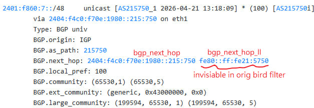

The current bgp_next_hop filter attribute only accesses nh[0] (the global address) of the BA_NEXT_HOP eattr.
The link-local address stored in nh[1] is completely invisible to filters.
see this image:
https://upload.cc/i1/2026/04/22/0Nj4E8.png
